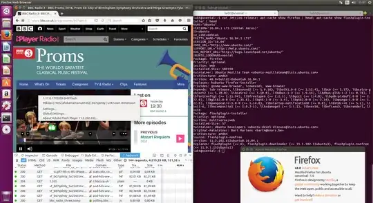

Flash on Ubuntu 16.04 never works on any browser; i.e.; chrome, chromium, and firefox. <<< updated, plugins enabled and updated, contents/privacy setting properly checked. dns pointing same as my windows pc, which plays flash on internet radios; i.e.; bbc.co.uk, tsf jazz, nhk online <<< none plays on ubuntu. What else to do? Now I can never listen to any internet radio.
I blacklisted the flashplugin-installer package on all my computers and uninstalled it because it's a very old version and I don't want that in Firefox. However I have pepperflashplugin-nonfree in Chromium which plays http://www.tsfjazz.com/player.html just fine, Chrome should also be fine.
Since you didn't provide any further details (I couldn't find the other examples you mentioned nor did you provide error messages or how it looks on your end) I cannot help you any further.
