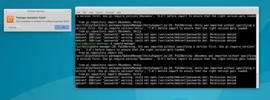

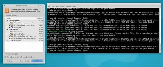

The Software Updater warns me about some updates available, but when I click "Install" it fails... What's going on?
If I run it from the terminal and that's what I see:
Start from terminal
After clicking "Install"
What I can do to solve this problem?
