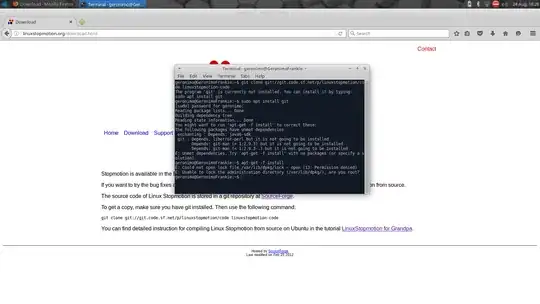

I am a new user of Ubuntu Studio (and know nothing about coding, etc), and I am trying to install Linux Stopmotion, but it relies on Git, which won't install.
I get the following:
Error on Terminal
Basically, when trying to install Stopmotion it says that the program 'git' is not currently installed. So I go through the motions and try and install git using apt-get, by adding repositories, by doing most of the things on here other people have suggested, and it comes back saying that the following packages have unmet dependencies, or simply doesn't work.
The error is...
enchanting: Depends: java6-sdk
git: Depends: liberror-perl but it is not going to be installed
     Depends: git-man (>1:2.9.3) but it is not going to be installed
     Depends: git-man (<1:2.9.3-.) but it is not going to be installed
E: Unmet dependencies. Try 'apt-get -f install' with no packages (or specify a solution).
(I have tried the -f install and it doesn't work either.)
I don't know anything about coding, and I have never used linux before and am a lot over my head. Can someone please help me out? All I want to do is install Stopmotion.

You need to run apt-get -f install with root rights. So execute:
sudo apt-get -f install
This fixes your broken dependencies.
Afterwards, do
sudo apt update
sudo apt upgrade
sudo apt-get check
sudo apt install git
The first command updates your package list, the second one upgrades your packages, the 3rd one will either output something like
Reading package lists... Done
Building dependency tree
to tell you your dependencies are fine now or it will tell you there are still problems. The last command will install git. You need git to do a git clone.
Then execute the git clone command again and it should work.
