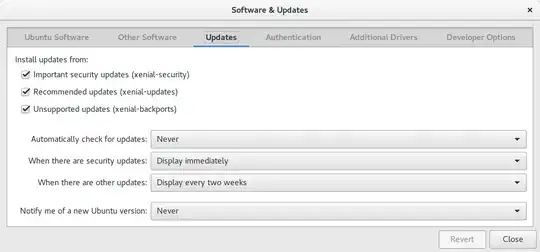

Here are my settings in the Software & Updates app: enter image description here
Ideally I could turn off the "Display immediately" and "Display every two weeks" options as well, but regardless it shouldn't be checking for updates at all, based on the "Never" option.
