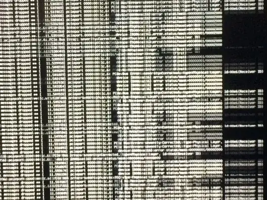

I have since tried running a redhat (fedora) and even kali(alternate debian) and have had the same crash. What will happen in the case of Ubuntu16.04 is that, after signing in, the screen will switch to the default Ubuntu screen but before Unity sidebar can pop-up, a message on the right will show up. The message is unclear as it flashes in and out of visibility too rapidly to read. There are no hot keys accessible such as cnt-alt-T, etc. Control-alt-delete is the only real available command and that interface box also flashes rapidly.
The machine must be powered off by holding down the power button and upon restart I run into a problem universal to all 3 Linux distros that I have tried. A black screen will show up and start scrolling illegible text at rapid pace. The text is unintelligible as it is seemingly layered on top of its self twice per line. It looks like a type writer wrote a page then scrolled up and typed over the former text but was slightly off center when re-written.

Thank you A picture was needed after all. After install and restart this is what happens

Finally solved this (hope the op is still checking this) Make sure your bios is current, double check that safe boot is OFF (you have to delete settings to do this, there are guides for it) and specific to the Asus G111cd mb.... turn off the pci energy management in bios as well as disable the non proprietary driver in the install config. it's wierd, but totally solved all of my install problems. once installed, immediately update the nvidia driver to their proprietary one, and then done. gl !
