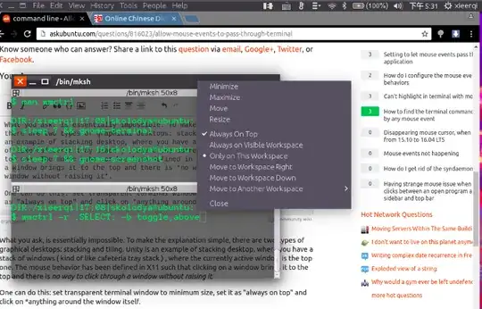

One can do this: set transparent terminal window to minimum size, set it as "always on top" and click on *anything around the window itself.
enter image description here In this screenshot you can see two approaches to this : one via default right click on window border and via wmctrl command. The last one can allow for scripting approach to this , but the basic premise is the same - you have to click on anything around teminal itself.

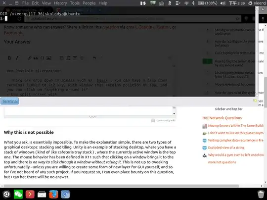

  • There are drop down terminals such as Guake. You can have a drop down terminal linked to F12 key, with window that retains position on top, and you can click on anything around it
