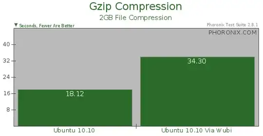

You've inspired an article on Phoronix, entitled The Performance Impact Of Ubuntu's Wubi Windows Installer, which on the 2nd, 3rd and 4th pages has a series of benchmarks that show quite clearly the performance impact, see an example below:
Gzip Compression benchmark in Ubuntu 10.10 and Ubuntu 10.10 with Wubi
