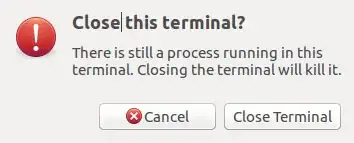

But when I close the window I get no warning even if there is a command that is being executed. So I change the Exec line as this:
Exec=mate-terminal -x bash -c "ssh -X lich@192.168.2.222"
But I still get no warning when I close the terminal window. How can I get a warning like this: enter image description here
I try this command to solved the issue.
Exec=mate-terminal -e "bash -i  -c 'ssh -X lich@192.168.2.222';bash"
I found the solution. I added the -i option after bash as this:
Exec=mate-terminal -x bash -i -c "ssh -X lich@192.168.2.222"
and the problem solved.
