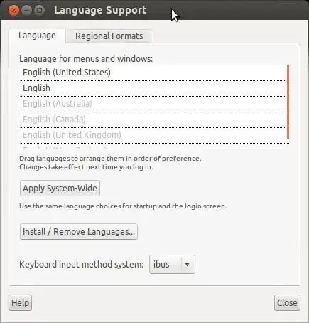

1) Use System Settings>Language Support to select IBUS as the Keyboard Input Method System.
Adding IBus as keyboard input method system @ Language Support

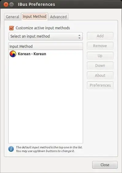

Click on it and select Preferences. Go to the Input Method tab and select Korean. Click Add.
Adding Korean input method @ IBus preferences
Now when you click on this second keyboard icon you can select Korean and a Korean icon will appear.

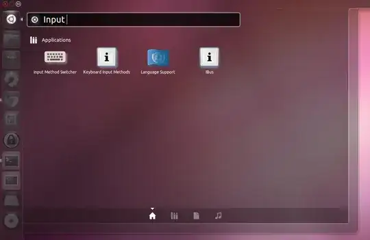

In the Unity Launcher, type in input. You will see a few options.
First go to Language Support. You should be able to select different formats to add to you profile by clicking "Install/Remove Languages".
After you have done this, you should be able to toggle between english and korean at the top right of your screen, next to your time and volume control.
If you are still having issues, type in Input once again from the unity launcher, and start
From there, I would also go to "Input Method Switcher"
Best of Luck!

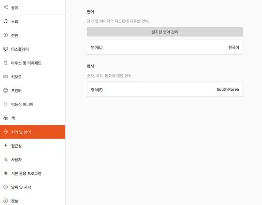

It's 2021 and the instructions have changed again.
  1. From Settings, open Language and Region
  2. Select Manage Installed Languages
  3. Click Install/Remove Languages
  4. Add Korean
  5. Reboot your computer
  6. Open Settings -> Language and Region again
  7. Click the + sign
  8. Add Korean (Hangul)
  9. Click the Gear icon beside (Korean Hangul), and enable "Start in Hangul mode"
To type in Korean, you can now hit Super + Space to swap between languages. The input method will also appear in your tray bar.

  1. Typed "input" into the dash, bringing up the screen above (in Jame's response).
  2. Clicked "input method switcher," and changed from default to use Ibus.

  5. I then clicked on the Ibus keyboard at the top left of my screen, and then preferences.
  6. In the preference window, I clicked on the middle tab "Input Method."
  7. Then I clicked on the "Select an input method," which gave me the choice of Korean or Chinese. I clicked on the Korean.
  8. Then clicked "ADD."
  9. Then I had the ability to switch from English to Korean! 그래 서 너 무 행복한다! Except for this weird spacing issue. Anyone have ideas for fixing the spacing? Doug

All I needed was
sudo apt install ibus-hangul fonts-unfonts-core
and a restart and I can finally see Korean characters
To add it as a keyboard option:
  • Settings -> Region & Language -> Input Sources -> + -> Other -> Korean (Hangul) -> Add
  • Korean (Hangul) settings -> Start in Hangul mode -> OK
  • Windows Key + Space to swith between input sources

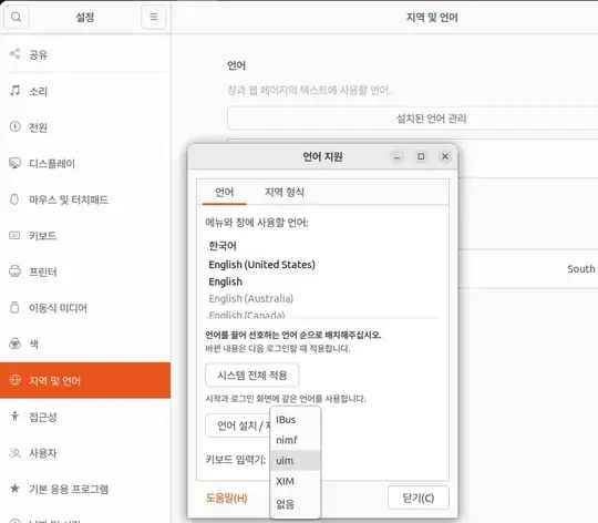

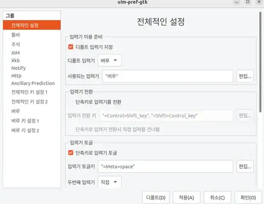

-1

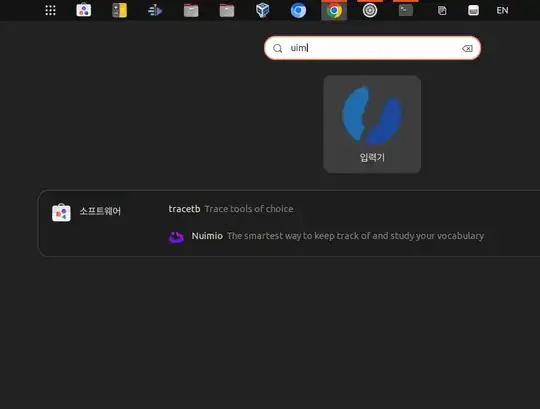

The Ubuntu hangul method is available with UIM and Fcitx. You will be able to write Korean without errors.
sudo apt install uim
sudo apt install uim uim-byeoru
https://fcitx-im.org/wiki/Fcitx_5
sudo apt-get install fcitx fcitx-mozc fcitx-hangul  fcitx-frontend-qt5 fcitx-frontend-gtk2 fcitx-frontend-gtk3 fcitx-config-gtk fcitx-ui-classic
