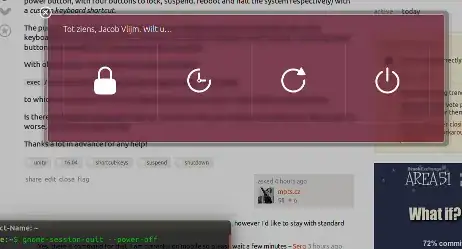

I have a newly installed Ubuntu 16.04 (with Unity) on a laptop and I would like to be able to launch the dialogue window (the one that is by default launched by pressing and shortly holding the power button, with four buttons to lock, suspend, reboot and halt the system respectively) with a custom keyboard shortcut.
The purpose of this is to be able to launch the dialogue with external (either USB or BT) keyboards when the laptop lid is closed and an external display is used instead, rendering power button inaccessible or inconvenient at the very least.
With old Ubuntu 12.04 I used this simple command:
exec /usr/lib/indicator-session/gtk-logout-helper --shutdown
to which I bound the Ctrl-Alt-Del keyboard shortcut (Log Off I redirected to Ctrl-Shift-Del).
Is there analogical command in Ubuntu 16.04 (or is this just another thing that was “improved” to worse, as so many seem to be)?
Thanks a lot in advance for any help!

The command:
gnome-session-quit --power-off
simply works, and does exactly what you want:
