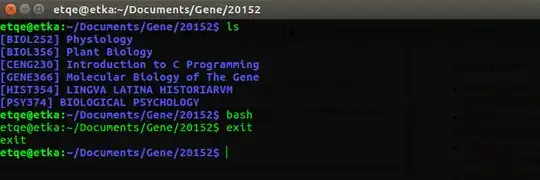

However if I try to run another bash shell in the current one, the prompt becomes unformatted:
Is that normal? Isn't the whole point of exporting a variable to make it accessible from all the child processes forked from that shell? Why it doesn't that apply to this situation?

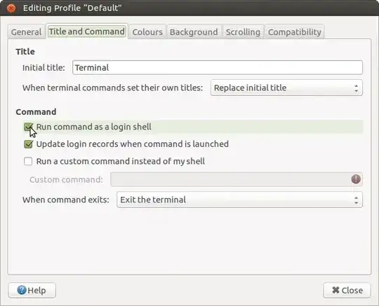

.bash_profile is sourced by login shells only. It has been sourced when you logged into the X-session, and the environment inherited as @Serg explains in detail. Somehow you have managed a configuration in which this environment is not overridden by .bashrc, perhaps setting your terminal to open a login shell by default. I can reproduce the behaviour you experienced by configuring my terminal like this:
this causes the shell to open as a login shell, but any child called will be a non-login shell, and source .bashrc, not .bash_profile unless, as @Serg suggests, the -l flag is used.
