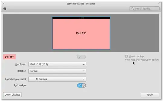

I am running Ubuntu (elementary OS) connected to a normal monitor which works fine. I am now trying to connect it to a TV through HDMI port, but the TV is unable get any signal. Please help me out.

I am unable to understand what needs to be done here. Could you please explain. I still am not sure if my PC sending some output via the HDMI port. Please help!
If you are trying to do a dual display, look into your "System Settings" for "Screen Display". There is usually a setting for "mirror display" (same thing on both screens) or "extend display" (have your desktop use both screens). On many installations, these don't turn on just by plugging a 2nd screen in.
If this is a single display and you are trying to replace a monitor by a TV, make sure that:
  • your TV can handle the resolution and refresh rates that the graphics card is trying to output
  • your TV is set to the correct HDMI outout that you've plugged into (my TV has 4, and you can cycle through them using the "input" button on the remote)
  • try another HDMI connector on the TV
  • make sure your graphics card is sending a signal through HDMI. You may need to edit your xorg.conf file for this, see details here.
