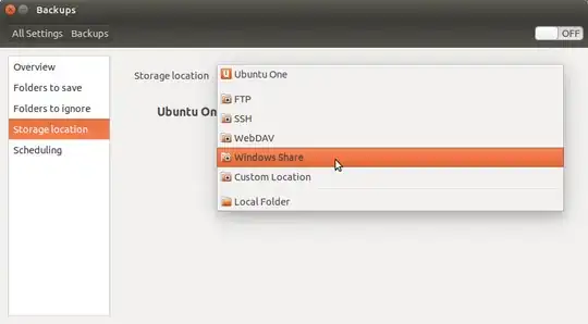

The standard "Backups" program in Ubuntu will do just fine. It is based on Deja-Dup. It should work with any NAS, since they almost all offer one kind of a networked file system or another (Samba typically, sometimes NFS). I'll start with the assumption of having a NAS that can do Samba.
If you have that, you just point Backups to that share and you're done. (Screenshots are 14.04LTS, because I'm too lazy to boot up my desktop which has 16.04LTS).
Screenshot of Backups, Location selection

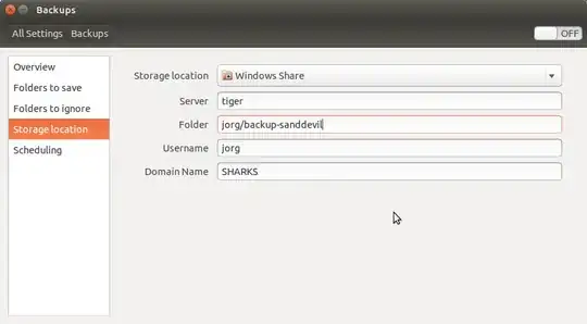

Then you fill in the required information.
I have a fileserver (that would be your NAS), which is called tiger. I want to use the share "jorg" on that server. On that share, the backup needs to reside in the folder named "backup-sanddevil". Hence: jorg\backup-sanddevil. Obviously, you need to create this folder on the NAS. The "Domain Name" is the Windows domain, and is usually useless, but do enter it if you know it. On home networks it is often "WORKGROUP".
For testing, go to "Overview" and click backup now. Follow the instructions, and the backup will start.
Once you are satisfied, toggle the switch in the top right corner to activate backups to be done automatically. Explore the settings and adapt to your needs (weekly backups, daily backups, etc...)
