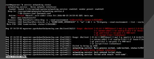

When running service networking status I get the following error report,
networking failure error report
It is failing to raise networking services and so I cannot access server, it also lists dhclient failure,

In 16.04, because of persistent naming, your interface is probably no longer eth0. Check:
ifconfig
For example, my ethernet interface is now enp0s25. Correct your /etc/network/interfaces file as needed and then:
sudo ifdown enp0s25 && sudo ifup enp0s25
Of course, substitue your interface name as needed.
