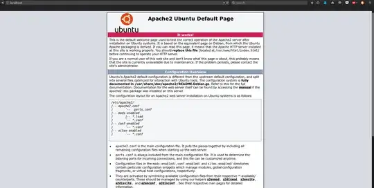

Point your browser to http://localhost:80 or http://127.0.0.1:80 or just http://localhost, Apache listens on port 80 by default, you should be welcomed with the following web page if the installation is successful: Apache welcome web page
This particular web page, and all other pages that Apache will serve are by default located in the /var/www/html directory on your system.

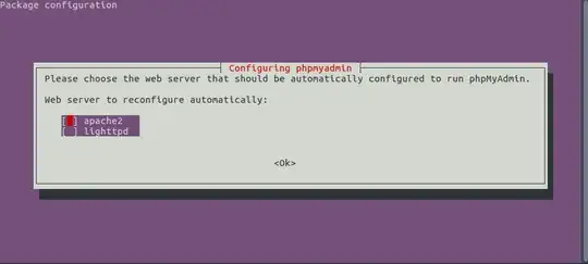

When prompted by the phpadmin installation choose of course Apache as the web server: phpmyadmin installation

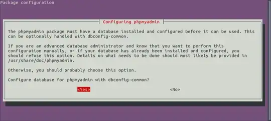

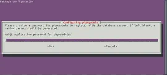

Choose then yes to let phpmyadmin configure with your MySQL server automatically: phpmyadmin auto-config
Type the same password you previously used in your MySQL server installation: type the phpadmin password

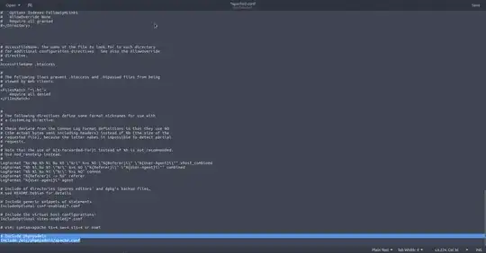

To make Apache work with phpmyadmin you'll have to configure the apache2.conf file. First open it:
gksu gedit /etc/apache2/apache2.conf
Then type (or paste) the following line(s) at the bottom of the document:
# Include phpmyadmin
Include /etc/phpmyadmin/apache.conf
adding phpmyadmin to the Apache conf

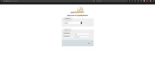

Point to http://localhost/phpmyadmin, it works! phpmyadmin login page

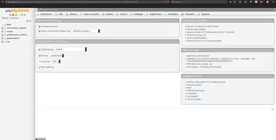

Log in as root by typing the password you've previously chosen for MySQL and phpmyadmin. Here's a screenshot of what you'll see once you log in: phpmyadmin control panel
