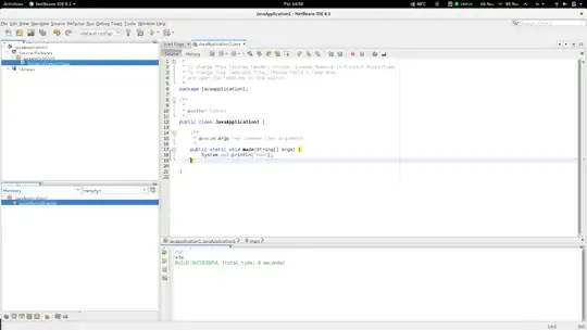

This is a fresh install of Ubuntu 16.04, I just installed Netbeans and fonts are half visible. How to fix it?
ferit
  • 258
You're using Ubuntu Gnome's default font Cantarell. Though I like this font, but it's Line Height is a bit higher, which is causing the menu label wrapping.
Install gnome-tweak-tool and change the font to something other than Cantarell. You can try Ubuntu font or install fonts-croscore package and use Arimo font, which is a great substitute of the Arial font.

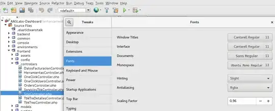

For me this issue start happening when I migrate from Unity in Ubuntu to Gnome Shell.
I used the gnome-tweak-tool as @Anwar suggested, but instead of changing the font, I just changed the scaling factor from 1 to 0.96 and it got fixed.
