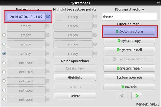

Systemback is a better then Windows Restore like program that can make live USB copy in a very simple way, no terminal needed. Also restoring from Live USB or on fresh install is also posible. It takes about 2-3min to make full backup of the system and can be scheduled at will. Works perfect under Ubuntu 14.04
