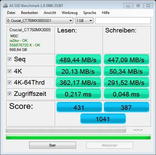

Their performance reads on Linux and Windows like this:
Crucial MX300 --> same on both OSs
sudo hdparm -tT /dev/sda # Crucial
Timing cached reads:   13700 MB in  2.00 seconds = 6854.30 MB/sec
Timing buffered disk reads: 1440 MB in  3.00 seconds = 479.58 MB/sec
Crucial MX300 725GB
SanDisk Plus --> way faster on Windows!
sudo hdparm -tT /dev/sdb # SanDisk
Timing cached reads:   7668 MB in  2.00 seconds = 3834.92 MB/sec
Timing buffered disk reads: 798 MB in  3.00 seconds = 265.78 MB/sec # TOO LOW !!
SanDisk
The sequential read performance of the SanDisk on Linux is about half of its performance on Windows!
