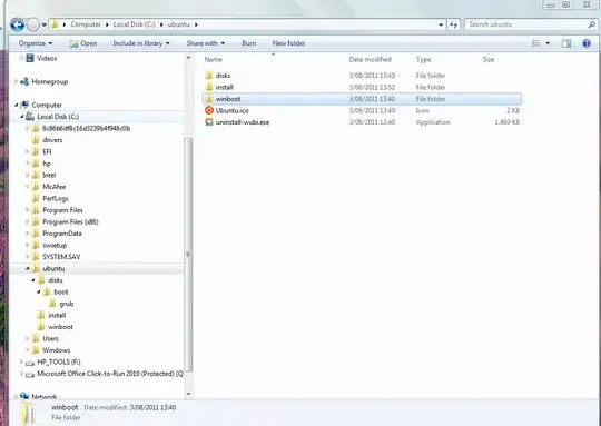

So, no Linux filesystem. I remembered Linux was installed from out of Windows, long time ago, something with wubi, see screenshot
Wubi screenshot
So, I cannot use this solution ? Boot drops to a (initramfs) prompts/busybox

As we discussed... get into the GRUB menu by holding down the LEFT SHIFT key immediately after selecting Ubuntu from the Windows boot manager. Then select the prior kernel and see if it boots. If yes, do some backups! Then try the 16.04 upgrade again (with Wubi, if you like). If that fails again, just do a standard Ubuntu reinstall/upgrade using a Ubuntu LiveCD that you've burned to a DVD. Cheers, Al
