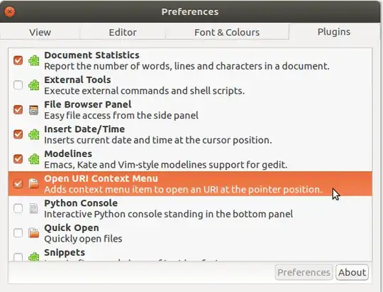

4. Setup for Xenial, Trusty and Precise:
Then on any of the LTS releases open gedit and navigate to the 'Plugins' screen by following this trail:
 Edit > Preferences > Plugins
and then activate the plugin by ensuring there is a 'tick' or 'check' mark next to the plugin description as seen in the screenshot below:

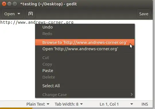

Now when you right click on a link (admittedly not left click as you specified) within a document opened with gedit you will see the following options:
The two plugin options seen here are:
  1. Browse to: Open the link in an external browser such as Firefox
  2. Open: Open the contents of the link within another gedit window
Works nicely on each of my Xenial, Trusty and Precise systems and should on yours as well...

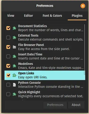

Modern versions* of gedit have the appropriate plugin built-in. Simply go to ☰ → Preferences → Plugins and enable "Open Links".
You can then right-click any link and a new context menu entry "Open Link" will be at the very top.
screenshot highlighting the described plugin in the list
*It was added in gedit 42, maybe a bit earlier.
