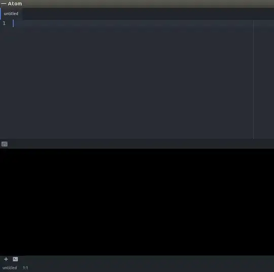

I am using Atom editor on ubuntu 14.04 LTS 64 bit and I installed terminal-plus package. I can create a new terminal but I cannot write into it as you see in the screenshot below
PS: I don't know if it's related to this error: Uncaught TypeError: Cannot read property 'focus' of null which I have.

The terminal-plus package is unmaintained with its last update being in November 2015. So I would like to advise that you switch to my Atom package (please note, that this package is only compatible with Linux platforms, if you want a terminal package to use on your non-Linux machines please use platformio-ide-terminal instead!), terminal-fusion. To install it merely run:
$ apm install terminal-fusion --no-confirm
where $ denotes a user console (so do not run this command as root!). I would advise that you uninstall terminal-plus first via running:
$ apm remove terminal-plus --no-confirm
If you would like to show your appreciation for my package, please star it with apm, by running:
$ apm star terminal-fusion
or star it on GitHub by logging into GitHub and clicking "Star" at the URL https://github.com/fusion809/terminal-fusion.
EDIT: This answer is now out-of-date I'm afraid as terminal-fusion is no longer maintained so please use platformio-ide-terminal instead. To install it run:
$ apm install platformio-ide-terminal --no-confirm
where is $ is the user console. To star it and thereby show your appreciation to its author (which isn't me, but they still deserve your appreciation) run:
$ apm star platformio-ide-terminal
