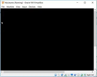

After it asks me for the login credentials, it pops several errors about needed updates but internet is not working. If I ignore(which I have no choice), I get full black screen:

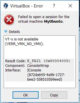

If I create a new Vm, and choose newer versions of Ubuntu, I get this error right away:
Well, after a long discussion in chat, we got everything resolved :)
There were multiple issues at play:
  • Making sure the OP used a supported LTS release (He was originally using an EOL standard release)
  • Making sure the OP's CPU supported VT-X
  • Making sure that VT-X was enabled in the BIOS
  • Making sure that Hyper-V was disabled, as Hyper-V and VBox cannot coexist
  • Making sure that the VM was set to "Ubuntu 64-bit" instead of "Ubuntu 32-bit"
  • Making sure the OP knew how to spell Ubuntu :P
In the end, everything was resolved and the VM worked fine.
