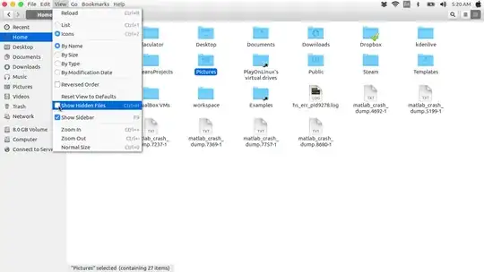

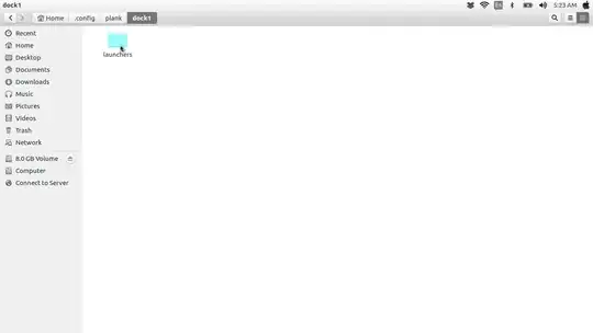

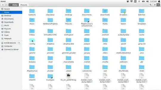

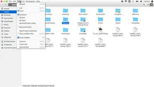

Open file manager by clicking on it

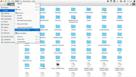

Go to View in Menu Bar
Go to "Show Hidden Files"
Tick the box left to it

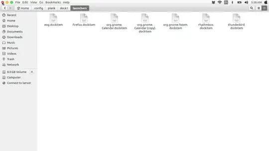

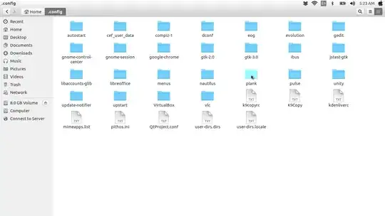

Click on .config

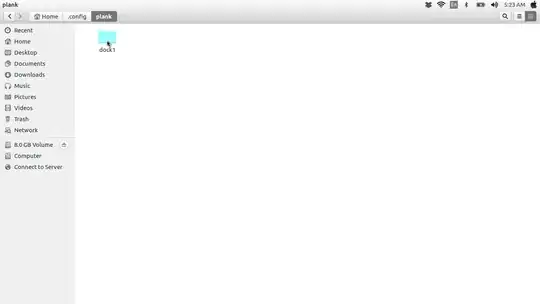

Click on plank
Click on dock1

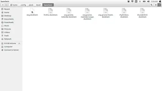

Click on launchers

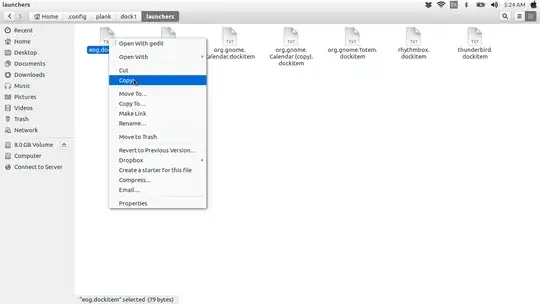

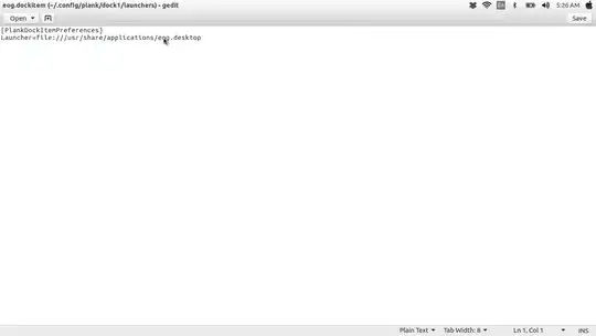

Go to any text file
Right click on it and select copy
Right click on any empty space in the same window and click on paste

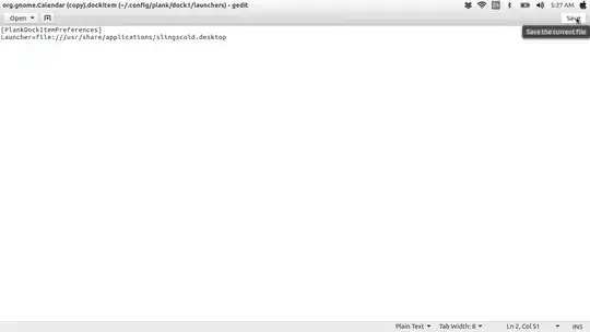

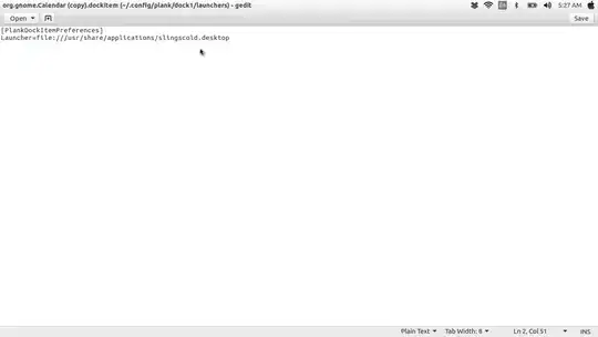

Double click on the newly created file
Delete the portion between applications/ and .desktop
Type slingscold in it's place.
Save and close the file

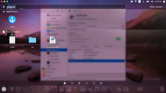

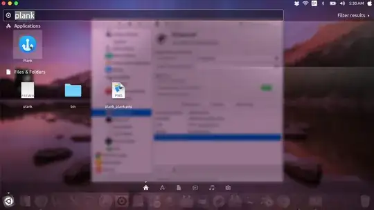

Go to Ubuntu launch icon
Type plank
Click on the plank icon that now appears
Plank now has slingscold icon on it
