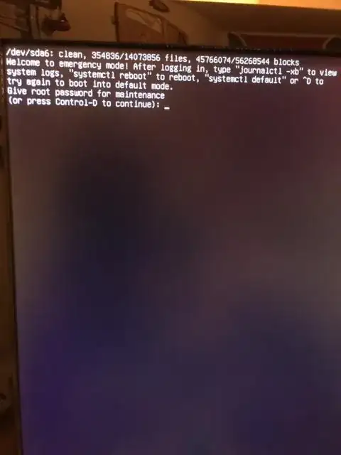

After updating Ubuntu it now boots into emergency mode. I'm new to this OS.
If anyone can help me out with the codes that would be great. I do not have the OS on a CD or USB.
Emergency boot mode image

If you do have high value files not backed up then I suggest you obtain a Ubuntu liveCD [or usb] and boot off it (which should avoid this screen ) ... once booted up then plug in a memory stick and backup treasured files/dirs
Now that your are booted up off the Ubuntu LiveCD open up a terminal ( ctrl+alt+T ) and issue
sudo -i    # to toggle into root
fdisk -l
at bottom you should see something like this
Device     Boot      Start        End    Sectors   Size Id Type
/dev/sda1  *          2048 1431805951 1431803904 682.8G 83 Linux
/dev/sda2       1431807998 1465147391   33339394  15.9G  5 Extended
/dev/sda5       1431808000 1465147391   33339392  15.9G 82 Linux swap / Solaris
Identify your boot device ( the one with * for me its /dev/sda1 )
issue
umount /dev/sda1
fsck -y /dev/sda1 # leave off -y if you want prompts to OK fix actions
reboot
The motive for booting off Ubuntu LiveCD is your normal drive can then be unmounted ... something you (cannot/should not) do when booted from it
