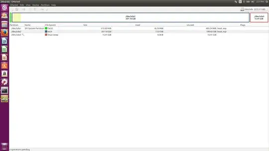

  4. adding "boot" flag to /dev/sda2 didn't work (file system ext4, see screenshot)
  5. I'm trying to boot in UEFI mode
