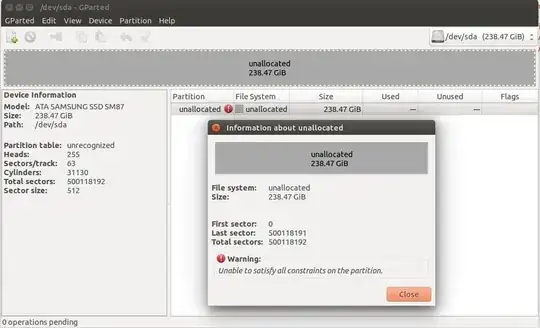

I have a dual boot Ubuntu 14.04/Windows7 and recently freed some space in the Windows partition to extend the Ubuntu one (using easeus). After that I used the Boot repair tool to fix the boot. Finally, I can't reallocate it since Gparted is seeing the whole SSD as unallocated...
Here's my gparted error message: enter image description here

I read on some posts that there should be some space (usually 1 or 2 Mb) between each logical partition to store the EBR. Unfortunately I don't know if this is really my problem nor how to fix it safely without Gparted.

If it can be of some help for any other user: My problem came from the Swap partition sda6. Too close from the previous one. It became "obvious" using Fixparts because the partition was omitted. So I rewrote the MBR partition without the Swap using Fixparts again. From there Gparted (v0.18.0) was back and allowed to modify the partitions
