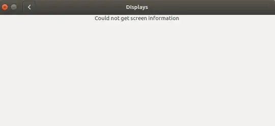

I have upgraded from Ubuntu 14.04 to Ubuntu 16.04 and now when I open Display Settings I get the message "Could Not get Screen Information"(here is a screenshot): Could not get Screen information
There are multiple questions related to that and I think this answer was most useful. I logged in with another user and for him the Display settings menu works just fine. So following the answer I get to the conclusion: It's likely going to be something in .gconf or .config in which case you have to dig deeper. The problem is that I don't know how to dig deeper.
I have already tried solutions in many other answers. I have reinstalled nvidia drivers, ubuntu-desktop, xorg, xserver-xorg and all other tips from this answer(short of fresh install that I really want to avoid).
I am using ubuntu 16.04(4.4.0-31-generic amd64) on lenovo w530 laptop. Any ideas on how I can fix the issue?

If you do a ps x|grep control-center command in a terminal window, you may expect gnome-control-center as result. Close this control center window and instead type unity-control-center in a terminal window.
This control center will show your screen information. Pin it in the launcher for future use and possibly pin out the former one.

reinstalling the Unity Control center worked for me :
sudo apt remove unity-control-center
sudo apt install unity-control-center
(Ubuntu 16.04 with Unity)

I've some trick for this: right click on screen, choose "Change desktop background", click on "All settings" and go to "Displays".
This way it's works for me, but through Settings -> Display doesn't
I had the same problem with 16.10. At some point, I did some clean up and one of the following removed unity-control-center:
sudo apt full-upgrade
sudo apt-get autoremove
The solution was to manually reinstall unity-control-center:
I now see 2 Settings apps in Dash: "Settings" (gnome-control-center) and "System Settings" (unity-control-center).
