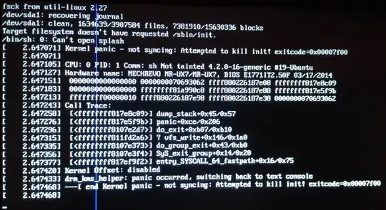

The first time upgrade process tried to reboot, it stops at a blank screen with a non-blinking cursor on upper left. After waiting for quite some time, I did a hard reboot, and then my system hangs at here:
Target filesystem doesn't have requested /sbin/init
Kernel panic - not syncing: Attempted to kill init! exitcode=0x00007f00

OK, I made my computer back to life again, but I don't really understand "how", so this is more of a follow up, but I think I'll post it anyway in case someone else encounter similar situation and want a hint.
Short story:
I used a Live USB to boot, followed this instruction to get into command line, dpkg --configure -a and apt-get autoremove, reboot into upstart mode, (sort of) finished the upgrade process.
Long story:
When I did the distribution upgrade I found my Internet connection was quite slow, so I mindlessly switched server to cn99 (China), which I think is where the damage came from.
The upgrade is fast, but when it went into first reboot (or I think it was the first reboot), the error in question appears.
Luckily I have another computer around, so I made a Live USB and used it to boot. It doesn't seem to work at first, showing errors like:
Undef symbol FAIL: __syslinux_shuffler_size
Failed to load libcom32.c32
Failed to load COM32 file gfxboot.c32
boot:
Following this solution, I pressed Tab, enter "live" and successfully booted into Xubuntu Live.
Then I followed this instruction:
Press Ctrl-Alt-F1
sudo mount /dev/sda1 /mnt
sudo mount --bind /dev /mnt/dev
sudo mount --bind /proc /mnt/proc
sudo mount --bind /sys /mnt/sys
sudo chroot /mnt
apt update
This was when I was told that my repository was corrupted and need to run dpkg --configure -a to correct it.
I also run apt-get autoremove since some other Google results suggested to do so.
Then I reboot and tried default (systemd) first, still failed, but upstart work.
I then check for software update, nothing new, and for some reason (thank god) I switch server back to main, and loads of update appears, and even a "Partial upgrade" window appeared.
I did the Partial upgrade, and at the end of installing it still shows error and just stopped, but the system was responsive, so I reboot (skipping the "Cleaning up" part) using systemd and this time it worked.
