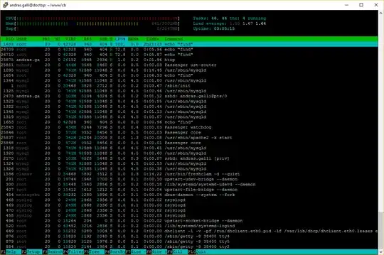

I have an Ubuntu 14.04 server, and found that some processes are running with root privileges and takes all my processor time. The processes are called 'echo "find"'. What are these, and how can I stop them?
echo "find" processes
