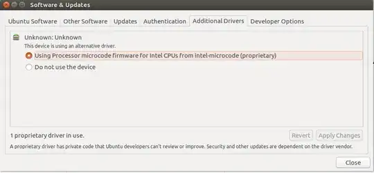

Currently the problems are: 1. can only log in with recovery mode / nouveau, 2. poor screen resolution, and 3. screen display shows "built in display" only.
My graphics card is: 1024Mb ATi Radeon HD 5770 PCI-Express VGA Card. It was working fine before moving from 14.04 to 16.04 yesterday.
I have an Intel CPU and I believe I am using the open source radeon driver.
Please, could someone tell me how to get the graphics card working again?
When I run this command: dmesg | egrep 'drm|radeon'
I get this response:
[    1.536906] [drm] Initialized drm 1.1.0 20060810
[    1.586158] [drm] VGACON disable radeon kernel modesetting.
[    1.586239] [drm:radeon_init [radeon]] *ERROR* No UMS support in radeon module!
[   44.543359] [drm] VGACON disable radeon kernel modesetting.
[   44.543388] [drm:radeon_init [radeon]] *ERROR* No UMS support in radeon module!
When I enter lshw -c video
I get:
  *-display UNCLAIMED
       description: VGA compatible controller
       product: Juniper XT [Radeon HD 5770]
       vendor: Advanced Micro Devices, Inc. [AMD/ATI]
       physical id: 0
       bus info: pci@0000:01:00.0
       version: 00
       width: 64 bits
       clock: 33MHz
       capabilities: pm pciexpress msi vga_controller bus_master cap_list
       configuration: latency=0
       resources: memory:e0000000-efffffff memory:fbdc0000-fbddffff ioport:ee00(size=256) memory:fbd00000-fbd1ffff
The output of sudo cat /etc/default/grub can be seen here http://paste.ubuntu.com/22074912/
screenshot
To start with, let's make sure you have a AMD CPU. Run this in a terminal:
cat /proc/cpuinfo  | grep 'name'| uniq
If this shows AMD, then you need to correct the drivers.
To get the correct drivers, first, select "Do not use this device" option. Then, from a terminal, run:
sudo apt-get remove intel-microcode iucode-tool
Now, run:
sudo apt-get install amd64-microcode
Then, go again to the "Additional Drivers" tab, and select proprietary option.
