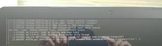

Someone knows how can i resolve this problem?
Error Image

Please have a look here:
Cannot properly boot into Ubuntu after installation of Nvidia driver
If you cannot login to tty (alt+ctrl+f1),
You may load you system by RecoveryMode
Benny
  • 5,100
Try to hold shift at the booting up, then you will come to the boot grub. There you'll see the word "quiet splash". Remove this and insert "nomodeset". Hope that helps you. Regards
