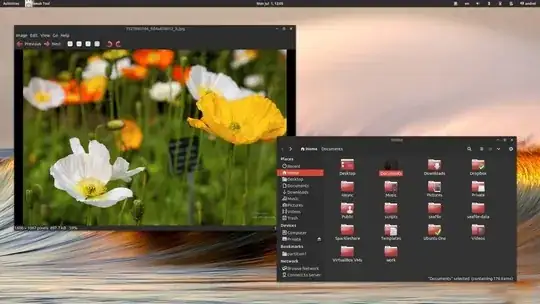

When using GTK3 themes on GNOME, GNOME Tweak Tool has an option to enable 'Global Dark Theme'. With Numix GTK theme, it produces this look: Numix with dark theme mode enabled on GNOME

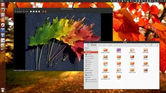

With Unity 7, when you use Unity Tweak Tool to change the theme from Ambiance to Numix, there is no way to enable the dark theme mode. The result looks like this: Numix on Unity 7
Is there a way I can make Numix in Unity 7 look like it does in GNOME when the 'Global Dark Theme' option is checked in GNOME Tweak Tool?

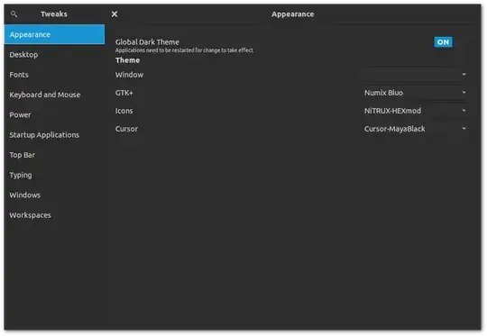

You can enable 'Global Dark Theme' mode on Unity 7, the same way it's enabled on Gnome Shell. Just install GNOME Tweak Tool by clicking here:
Install GNOME Tweak Tool
Or run this in Terminal:
sudo apt install gnome-tweak-tool
When it's installed, open Tweak Tool from the Dash and toggle on 'Global Dark Theme' switch as shown below:
GNOME Tweak Tool
From now on you can use the dark mode of themes under Unity 7 the same way you use them on GNOME! If it's not working, just check if the theme implements GNOME's dark theme mode.
