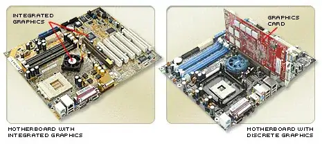

Motherboards with integrated and discrete graphics
Integrated graphics can be integrated onto the motherboard as part of the chipset and/or within the same die as the CPU1
