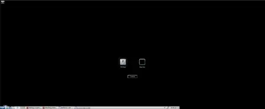

Everything worked fine on Linux Mint, but somehow doesn't in Lubuntu. You see, when on Linux Mint, the login window was centered, on Lubuntu, it's way off to the right (seen on the image below). And that means when he logs in to his remote desktop, all windows are off-screen too, so basically a percentage of window is lost on the right side of the screen.

When I exited the full screen mode (with CTRL+ALT+ENTER) and made a screenshot of the rdesktop window, I'd actually see the cause of the problem. enter image description here
You see, rdesktop thinks that my monitor is way bigger than it actually is. Or it thinks I have multiple monitors hooked up. The screenshot's resolution came to be 2480x1025.

Ehh, apparently the solution was so simple. It looks like the resolution set from the Start-menu's "Monitor settings" does not actually set the resolution to the given value. Googling around, trying different keywords, I stumbled upon this tool, named xrandr. I'm not entirely sure what xrandr is capable of doing, but one of the features is that, you can set pretty much any resolution, using this command-line tool. So, here's how I fixed the anomaly I described in the original post.
  1. To verify what's your current actual (not the one displayed in monitor settings) resolution is, type in: xrandr -q. Even though the "Monitor settings" resolution was set to 1680x1050, the output of xrandr -q told me my "current" resolution is, surprise-surprise 2480x1050: $ xrandr -q Screen 0: minimum 320 x 200, current 2480 x 1050, maximum 4096 x 4096
