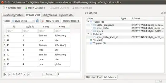

In the main window you can click Open database to open your *.sqlite file. It will then display something like this (here displaying the database of a Firefox add-on for applying user styles):
I already switched to the Browse Data tab on the left panel, where you can view the database table contents now. You select which table to display in the "Table:" combobox.
