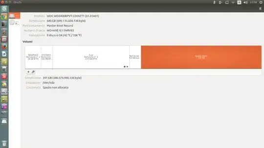

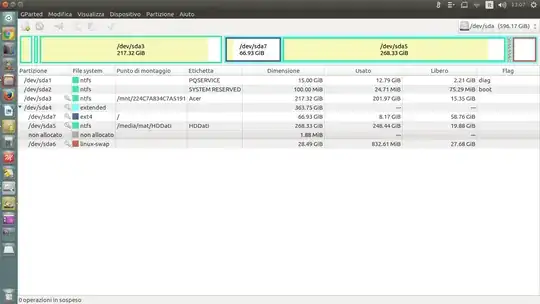

After a clean-install of 16.04 alongside W7 my shared partitions did not auto-mount at boot. I opened "disk" in launcher and surprisingly the partitions are not like shown in gparted (and in reality) and as a result I cannot tell the gnome-disk-utility to automount them.
  • gnome-disk-utility 3.18.3.1
  • UDisks 2.1.7 (compilato su 2.1.6)

"disk" output
gparted output
Any ideas?

sudo LC_MESSAGES=POSIX fdisk -l /dev/sda
Disk /dev/sda: 596,2 GiB, 640135028736 bytes, 1250263728 sectors
Units: sectors of 1 * 512 = 512 bytes
Sector size (logical/physical): 512 bytes / 4096 bytes
I/O size (minimum/optimal): 4096 bytes / 4096 bytes
Disklabel type: dos
Disk identifier: xxbxxx7ae0
Device     Boot      Start        End   Sectors   Size Id Type
/dev/sda1             2048   31459327  31457280    15G 27 Hidden NTFS WinRE
/dev/sda2  *      31459328   31664127    204800   100M  7 HPFS/NTFS/exFAT
/dev/sda3         31664128  487419903 455755776 217,3G  7 HPFS/NTFS/exFAT
/dev/sda4        487421950 1250263039 762841090 363,8G  5 Extended
/dev/sda5        627788133 1190512889 562724757 268,3G  7 HPFS/NTFS/exFAT
/dev/sda6       1190516736 1250263039  59746304  28,5G 82 Linux swap / Solaris
/dev/sda7        487421952  627787775 140365824    67G 83 Linux
Partition 4 does not start on physical sector boundary.
Partition 5 does not start on physical sector boundary.
Partition table entries are not in disk order.
I solved the problem in some way some time after posting the question. It works now, but I don't remember how I did it. This partition 4 and 5 boundary problem came out only now, though.
