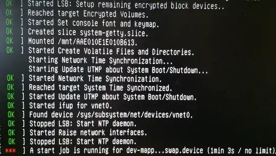

I again have problems with my swap. I using an encrypted swapfile. It worked until i rebooted my PC. When im trying to boot it is just showing this: Boot problem I disabled my swap in the recovery mode for now. But i am really confused why it has this boot problem.
/etc/fstab:
UUID=479cf731-657a-4f19-bd30-975b4019299f /               ext4    errors=remount-ro 0       1
/dev/disk/by-uuid/AAE010E1E010B613 /mnt/AAE010E1E010B613 auto nosuid,nodev,nofail,x-gvfs-show 0 0
/dev/mapper/cryptswap none swap sw 0 0
/etc/crypttab:
cryptswap /swapfile /dev/urandom swap
If any further information is needed, let me know and I will post it.

The comment from @jarno helped a lot. Instead of killing the machine with a hard power down, simply press Ctrl Alt Del.
