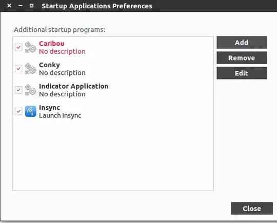

in ubuntu open dash (the ubuntu button) and type startup
then you get this:
Press add and type at the command rule:
incase of the ubuntu terminal gnome-terminal -x "sh /path/to/script.sh"
incase of xterm (which i prefer) xterm -e "sh /path/to/your/script.sh"
then reboot and see if it works :)
