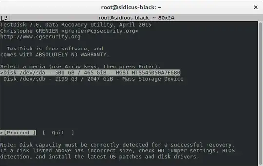

I'm trying to recover the data of a damaged hard drive using testdisk. I did all good, did the quick search, the deeper seach, and then, after confirming that my files had been found by testdisk, I wrote the partition table. and restarted the computer. So, now I think I got an even bigger problem. The hard disk is now sowing in testdisk as a 2199GB drive, and if I plug it directly into the SATA port, as recommended in the testdisk FAQ, even my BIOS can't recognize it properly, and I can't run testdisk again since it doesn't recognize the drive with it's normal size (that's 500GB).
Trying to mount the drive for read only to an attempt to recover data isn't working either, I get the message that the "NTFS is inconsistent".
I tried to see the drive in the Windows Disk Manager, but it takes a really long time to show up, and still showing as raw, with no info about its size.
enter image description here the output of testdisk in recognizing the drive. You can see my personal hard drive(sda) and the drive I want to recover(sdb) both should list as 500GiB.

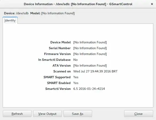

if I use smartmontools or gsmartcontrol to see the hard drive status I get this as result:
enter image description here the details screen for the drive

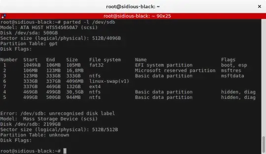

EDIT 3: The command parted -l /dev/sdb output goes as below: enter image description here
the sudo grep -abiro "NTFS " /dev/sdb command output gave me, after some time of running:
grep: /dev/sdb: Input/output error
Correcting the print, looks like the sdb unmounted before I did the parted command, the image above is the real output.
One thing to notice, the grep command after the first output taking around 20 seconds, does instantly give the same output if I run the command again without unplugging the drive.

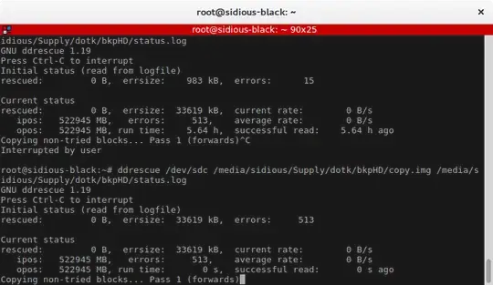

ddrescue has been running for some hours by now, but I'm finding some points weird in the behavior of the outputs, as follow:

Second, the command output can be seen here: enter image description here
I'm not sure if the values presented in the rescued, ipos, and opos are wrong or not, so I ask someone to tell me if should be like this. the drive has a real capacity of 500GB, and some of the numbers shown are bigger than that.
Also, the size of the copy.img file is 0 bytes. Does this means that there's no data being copied or that there's no sucessful data to recover?
EDIT 5:
After a long process and wait, with a lot of replugging the drive to keep the process going, looks like ddrescue finished, but the .img file has 0 bytes. Did I do anything wrong? I just followed the instructions given.

sudo ddrescue /dev/sdb /media/user/External/copy.img /media/user/External/status.log
The status.log file is not mandatory, but it is needed if you want to pause the process and resume later on.
As you can see, you will need another drive that is big enough to hold a copy of the entire 500GB drive (basically, a hard disk at least 1TB large). In my example it is mounted on /media/user/External. Adapt the example to your situation.
The ddrescue tool saves its progress in the /media/user/External/status.log file. This is very useful because the drive might "disappear" due to I/O errors (like it did while grepping). The program will stop. You will re-connect the drive and run the same command again: it will continue from where it was stopped.
Moreover, ddrescue reads "good" and "big" blocks first, then it comes back to more damaged areas later trying to reduce the amount of data read in a single operation until all the good bits have been isolated.
Even though the drive shows as being a 2TB drive, it is actually a 500GB drive. Therefore, the process of copying the drive will stop at 500GB.
