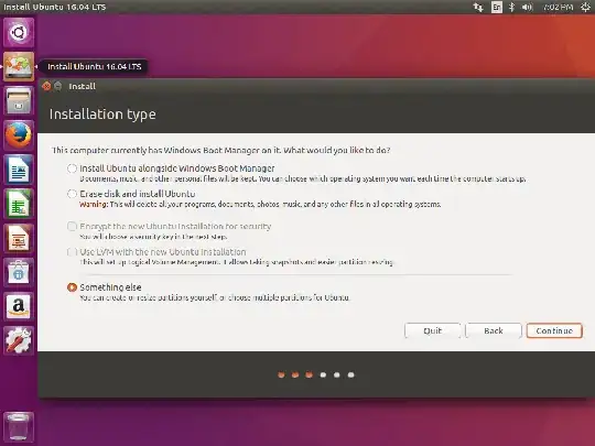

2)Reboot and boot from your installation disk/USB, when it asks for Installation type, Select the 1st option . i.e
  • Install Ubuntu alongside Windows Boot Manager
(the image below was copied from google image search)
3)You don't need to configure any kind of parition here , setup will automatically do this for you.
