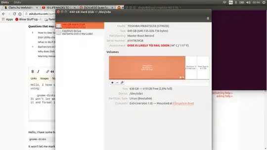

I have some bad sectors on my drive, but when I open disk utility using:
gnome-disks
It won't let me mark them, or do anything with the driver except benchmark it and format it!
enter image description here Please help, my disk is most likely to fail on me right now!
