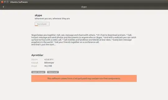

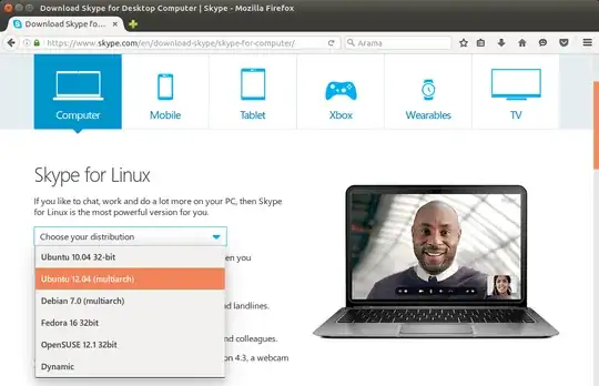

This is a no command line installation option. I did it as a dummy user. Hope it helps. 1. Browse to https://www.skype.com/en/download-skype/skype-for-computer/ 2. Choose Ubuntu 12.04 (multiarch) from the drop-down menu
Image 1
  1. Let it download..

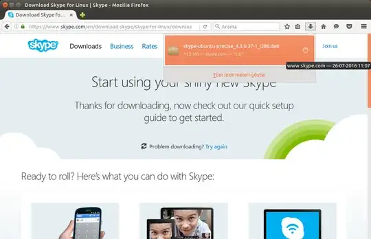

  2. After finishing the download, just click the file from the browser
Image 2

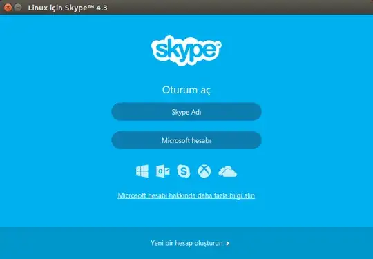

  1. After completion of the installation, just find the app and open it.
Image 4

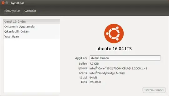

  1. My sample Ubuntu Desktop was like this:
Hope it helps.
