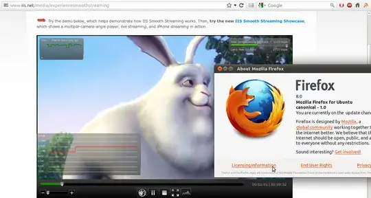

The web browser I use is Firefox (currently in version 8 in Oneiric). According the Compatibility Check information the Moonlight extension is not compatible with FF8. Anyway, I enabled this extension using the AddOn Compatibility Reporter. And, actually, I cannot watch Silverlight streams in an acceptable way: the video gets stuck, the HD keeps buffering (I guess), so I have to close the window.

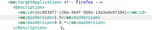

  • find the area in the file shown - change the maxVersion from *4.0.** to *99.0.** and save (N.B. picture shows 9 - this value needs to higher than your Firefox version)

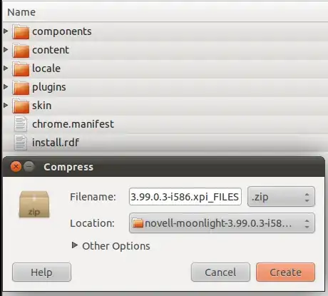

  • Highlight all the files - Right click and choose Compress - save the compressed file in Zip format enter image description here

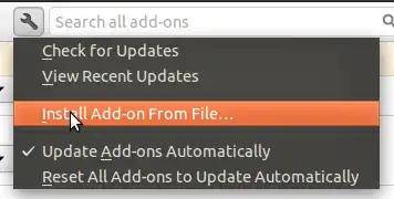

  • In firefox you can use the Firefox Addon wrench symbol to install the modified addon - you will be warned about its authenticity which you can ignore. This warning appears because you deleted the authenticity checks folder META-INF previously. enter image description here

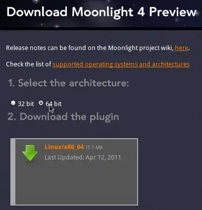

Since the latest versions of the Chromium browser are supported, for now I recommend using Chromium when you need to view/play Silverlight content. You can get Chromium by installing the package called chromium-browser (you can do this in the Software Center or by running the command sudo apt-get update; sudo apt-get install chromium-browser in the Terminal). Then, in Chromium, you can download the Moonlight plugin here. Unfortunately the Moonlight website does not properly detect your architecture in Chromium, so it will always suggest the 32-bit version of the plugin; if you have the 64-bit version of Ubuntu, then you should click the radio button for the 64-bit version of the plugin.
Select the architecture, then download the plugin.

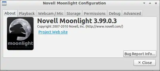

Once you've installed Moonlight, you might want to configure it. To do that, right-click on any Silverlight content (on any page) and click Moonlight Settings. This brings up the Novell Moonlight Configuration window.
Some Silverlight content requires that the Microsoft Media Pack be installed. You can install this from the Playback tab of the Novell Moonlight Configuration window.

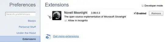

If you decide you want to enable Moonlight in Incognito mode, you can do so the Extensions tab of the Chromium preferences. Click the karat triangle to the left of the entry for Moonlight and then check the box labeled Allow in Incognito.
Chromium preferences for extensions
Please note that Moonlight will only be disabled by default for Incognito mode. For normal browsing, it will be enabled by default.
