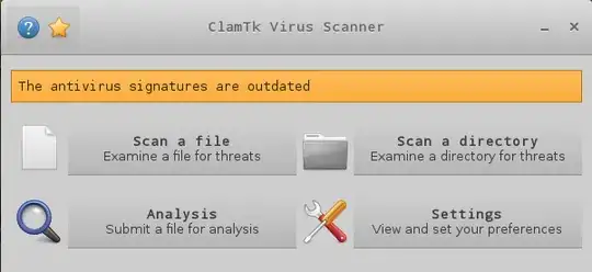

there is also a graphical front-end for it - Clam TK - this is optional, but you need clamav for clamtk to work. The devs describe it as:
An easy to use, light-weight, on-demand virus scanner for Linux systems
To get this too:
sudo apt install clamtk
