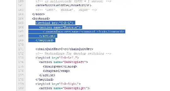

You should be able to bind the screensaver lock command to CTRL+ALT+L by editing your Lubuntu keyboard & mouse configuration file
Add the following to ~/.config/openbox/lubuntu-rc.xml
<keybind key="C-A-L">
  <action name="Execute">
    <command>xscreensaver-command -lock</command>
  </action>
</keybind>
This should be located inbetween the XML tags
<keyboard>
</keyboard
Logout and login for the changes to take effect.
