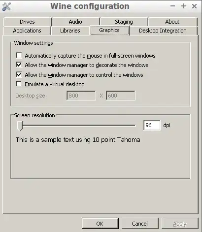

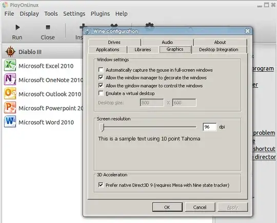

For reference, here is what the graphics menu should look like this:
And here is what it looks like for me:
