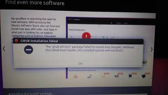

While it was finalizing the installation, suddenly an error message popped up:
Screen shot of grub failing:
After that the screen was responsive (I could move mouse, open file explorer, click on icons) but I couldn't run any command in the terminal, not even sudo reboot.

Reboot, and install as usual. At the end of the installation the same error will pop up, telling that grub has failed to install (it tried to install a 64bit grub2).
