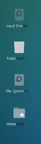

I'm not sure where I need to go to tweak this icon text being so far offset. Please see the screenshot below:
I'm using Xubuntu 16.04 64-bit with Arc theme and Paper icon theme.
EDIT: This happens when the update shown below is applied. Here's a link to patch causing the problem.
Here's the bug related to the issue: gtk2-engines-murrine desktop text shadow problem
Until that's fixed, I downgraded to the previous version of the package
sudo apt-get install gtk2-engines-murrine=0.98.2-0ubuntu2
Then to prevent the package manager from automatically updating the package in the future
sudo echo "gtk2-engines-murrine hold" | sudo dpkg --set-selections
