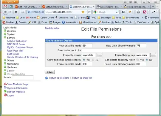

UPDATE 2: I've kinda fixed my issue by changing my samba settings. Using Webmin, I was able to go in and change the default settings (as seen here: http://imageshack.us/photo/my-images/521/captureon.png/)
Daniel Hollands
  • 233
This was fixed by the user by setting the following file permissions using Webmin:
  • New Unix file mode: 664
  • New Unix directory mode: 775
  • Force Unix user: www-data
  • Force Unix group: www-data
  • Allow symlinks outside share?: Yes [questionable]
  • Can delete readonly files?: No
  • Force Unix file mode: 000
  • Force Unix directory mode: 000
