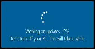

The other day I had a Windows 10 VM running on my Ubuntu 16.04 host that took a really long time to complete updating. I kept checking on its progress via Expo (Super+S) on Ubuntu. That got me thinking that this problem has most likely been solved already since tools such as simplescreenrecorder can be configured to record just a portion of the screen. However, I don't know the proper terminology to use for my Google search.
I'd like to see the 300x150 screenshot below in the form of a floating window (with live updates) in the top right corner of whichever workspace happens to be current.

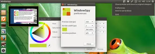

The answer below is now available in a polished form, as an indicator, as a ppa for Trusty, Xenial, Yakkety and Zesty :
sudo apt-add-repository ppa:vlijm/windowspy
sudo apt-get update
sudo apt-get install windowspy
Th indicator (including preview window) is now nicely low on juice. Options include a settings window, setting window border size/color, window size.

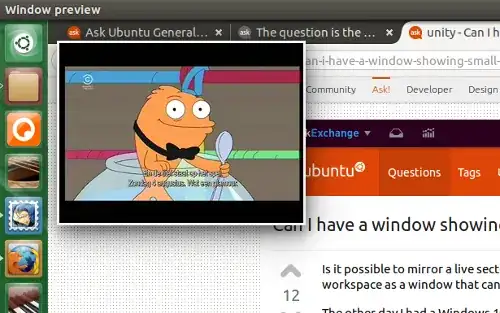

Have a minimized representation of a window on another workspace

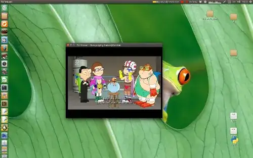

To my own (big) surprise, it can be effectively done, be it with trickery and deceit; have an updated representation of a window on another workspace. Not fit to watch a movie, definitely good enough to keep an eye on a window elsewhere (example: my tv-card window):
How it works in practice
  1. With the window in front, press a shortcut key:
    (the window will minimize)
  2. Move to another workspace, press the shortcut key again, a small representation of the window will appear, updated every 4 seconds:
    The window always shows on top of other windows. As it is, the window is 300px (width), but can be set to any size.
  3. To end it, press (again) the shortcut key. The small window will close, you will move to the viewport of the original window, which will appear again, unminimized.
